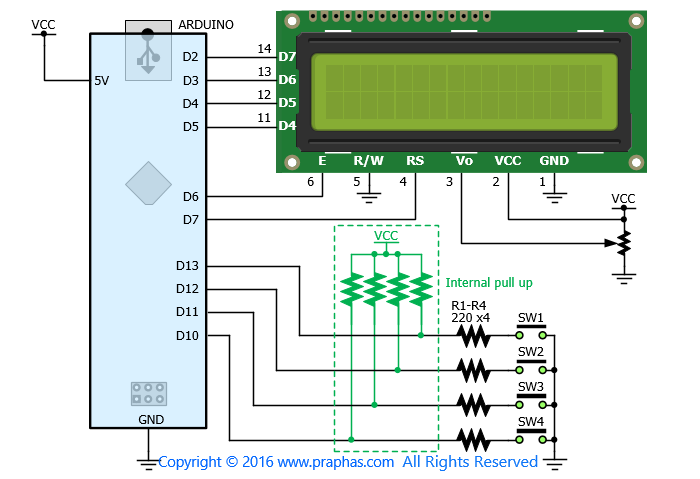

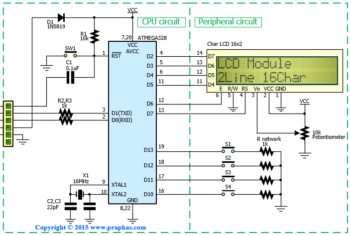

/* The circuit:
 * LCD RS pin to digital pin 7
 * LCD E  pin to digital pin 6
 * LCD D4 pin to digital pin 5
 * LCD D5 pin to digital pin 4
 * LCD D6 pin to digital pin 3
 * LCD D7 pin to digital pin 2
 * LCD R/W pin to ground
LiquidCrystal lcd(7,6,5,4,3,2);       // set up the LCD's connection pins
